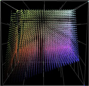

I've been spending some time diving deep into ColourSpace's Custom Filter system, specifically exploring how it can be leveraged to improve LUT accuracy before generation — rather than trying to fix things after the fact with smoothing filters.
The concept: Instead of blindly generating a LUT from a raw profile (which inevitably contains some measurement noise, especially in the near-black region), I built what I'm calling a "LUT Core Stability Filter" — a Custom Filter expression using the available constant tokens (R, G, B, L) that surgically identifies and isolates problematic measurement points while preserving all structurally critical data points that the Colour Engine needs for accurate interpolation.
The key insight is that not all profile points are created equal. Grey scale and primary ramp measurements are structural anchors — the Colour Engine relies on them for EOTF and gamut interpolation. Removing those in the name of "noise cleanup" actually degrades LUT quality. My filter protects these axes completely while only flagging the truly noisy volumetric interior patches in the shadow region — the points most susceptible to probe noise and least critical for LUT structure.
The workflow is straightforward: Apply the filter → Point Info → Save Selection → clean profile → generate LUT from that. No smoothing, no post-processing, no mathematical band-aids. Just cleaner source data going into the Colour Engine.
The 3D CIE graphs below show the difference. Look at the tangent lines in the shadow region — the filtered profile (second image) shows noticeably cleaner behavior with fewer stray vectors, while retaining full structural integrity across the grey axis and primaries. The LUT generated from the filtered profile produces measurably tighter results across the board.
This approach works particularly well for displays with extreme native gamuts (think triple-laser projectors targeting P3) where the gamut mapping interpolation is already under stress — feeding it cleaner source data makes a real difference.
I'm running ColourSpace HTL with a JETI 2501 and Admesy Prometheus. Would love to hear if anyone else has been experimenting with Custom Filters for pre-LUT profile optimization.

#4 | Posted: 5 Apr 2026 09:16
It is correct that there are no Required patch measurements for ColourSpace when using the main Peak Chroma LUT generation.
Other LUT Generation options do have requirements, as explained in the User Guides.
(But the need to use anything other than Peak Chroma would be for very specific display issues in reality.)
And yes, removing grey scale patches can indeed improve the final grey scale calibration, especially when the display's white point is not accurate or changes throughout the grey scale range.
And as said above, that is explained in the Focused Patch Sets use guide.
The same for Primary and/or Secondary measurements, and as mentioned for gamut edge measurements.
Very specifically:
Is NOT correct.
With ColourSpace ALL POINTS ARE ABSOLUTELY EQUAL.
And no, there are no such things as structural anchors, which is why 'Filtering' works.
And specific points are most definitely NOT used for EOTF and gamut interpolation.
Removing any point is the same as removing any other point... They are all created equal within the eyes of the ColourSpace Colour Engine.

#8 | Posted: 11 Apr 2026 10:29
While the results are good, there are a number of incorrect statements/assumptions made here, but without the actual profile to assess it is impossible to be totally specific on what exactly is incorrect, and why.
But for example:
Peak Chroma produces visible artefacts in the 3D Cube LUT preview — a reliable indicator that the algorithm can't handle that magnitude of gamut difference cleanly.
Is not a correct statement.
If the LUT preview shows any artefact it will be due to either the profile containing invalid data, or that there is gamut edge clipping - the display cannot actually cover the target gamut.
The colour engine algorithms never struggle with gamut spread, if the profile data is valid, and the display can cover the target gamut.
Looking at the Original granger image shows that the display has issues in the yellow/green region, and with Gamut Mapping disabled, you will see areas of flat colour in the granger where the gamut edge issue resides. That is where gamut mapping would likely help, assuming the profile is valid with accurate data.
Unfortunately, many probes struggle with accuracy with wide gamut displays.
With the concatenation approach such gamut edge issues will be cleaned, as the second technical LUT is just a matrix, so cannot perform such volumetric corrections, and so will not show such gamut edge issues.
See the LUT Concatenation page, as well as the Matrix Profiling page.
This is also basically the same as using Map Space.
Additionally, as you hint at in the end, if the grey scale colour temp. is not accurate, the actual grey scale patches in the profile will not be the patches that are actually correcting the grey scale. So using more will not necessarily improve the final grey scale calibration.
That is why actually removing such patches from the profile can improve final grey scale calibration, as that then leaves the actual patches that are going to be used for grey scale calibration to do their work, without being impacted by off-axis patches.
And that is why Focused Patch Sets work so well with grey scale.
And which can also be used for gamut, as if the display's gamut is far greater than the target, there is no point profiling outside the target gamut...
