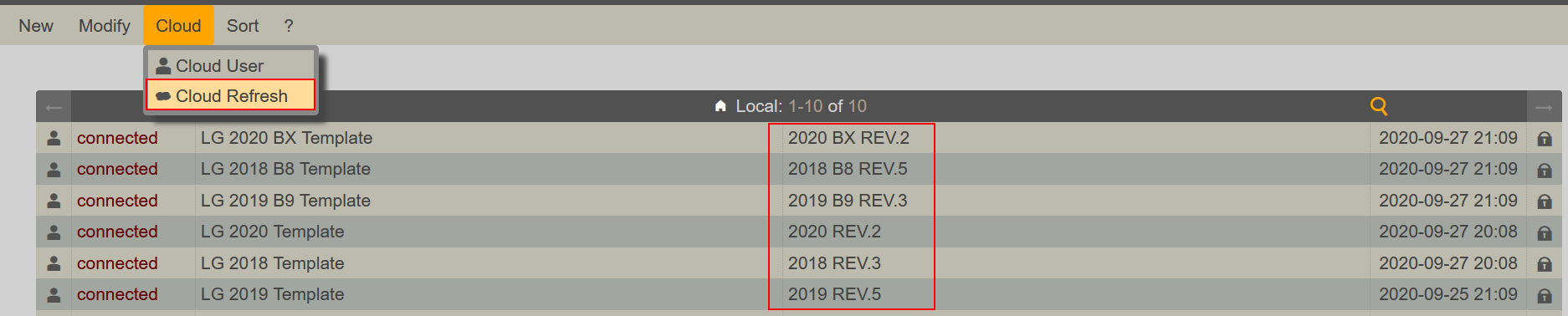

I have updated the LG Templates with new Revisions for the following Templates:
LG OLED 2018 / 2018 B8
LG OLED 2019 / 2019 B9
LG OLED 2020 / 2020 BX

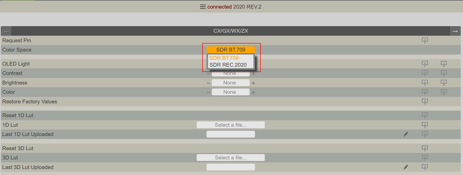

LG OLED's have two SDR LUT Slots, for SDR REC.709 and SDR REC.2020.
Since now, we were using the SDR REC.709 slot.
As we know, since LG's have several LUTs / modes (SDR/HDR10/DoVi), the TV's procedure to trigger the correct mode we want, it has to playback from USB or HDMI input the correct signaling before Enabling Calibration from Device Control.
TV will see the AVI infoframe from the HDMI input or see that encoding info from the Media File of USB and then enable the proper mode.
For SDR, we were using SDR REC.709 as the Media File provided from LG had encoded for YCbCr REC.709, which will trigger the TV SDR REC.709 slot.
When you are using an external generator, like Murideo/Accupel/DVDO, and you send YCbCr output, it will enable the SDR. REC.709 slot.
When you are using PGenerator with RGB signaling, it will enable SDR REC.709.

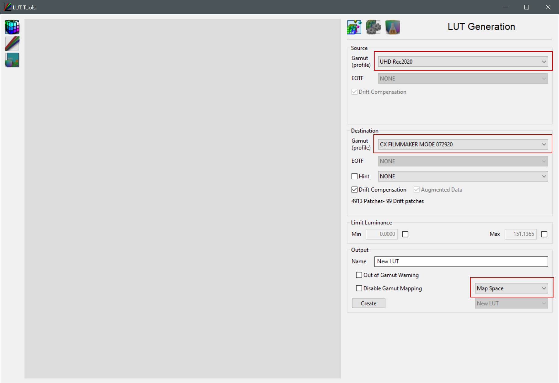

So after the end of the SDR calibration/verification of the 3D LUT for SDR REC.709, using that profiling data file, users have to generate an additional correction for SDR REC.2020.
Using the LUT Tools of ColourSpace, select as Source the REC.2020 UHD and at the destination the profiling file.
User with recent Calibration (before one month as an example), they can find that profile data file and use it to generate SDR REC.2020 correction.
Use 'MapSpace' for LUT generation since its the correct method when the target colorspace (REC.2020) is larger from the LG panel gamut capabilities (~ P3).

Uploading SDR REC.2020 3D LUT to LG:
After enabling Calibration using any of the methods above, select your picture mode, select SDR REC.2020 and upload the 3D LUT file.
If you want to test if the TV is uploading correctly the REC.2020 LUT you want and trigger it using DeviceControl, then you can use that Black/White 3D LUT (DeviceControl) file.
Upload that 3D LUT, and the SDR REC.2020 content will become black/white.
