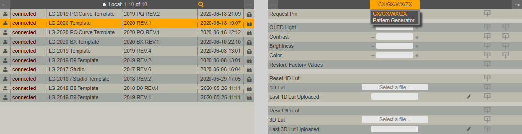

It is available for ColourSpace/LightSpace user (with HTL license level or higher) the LG 2020 Template with iTPG support (BX, CX, GX, WX, ZX)
The LG 2019 Template has been updated to REV.4, to provide iTPG support also.

For LightSpace/ColourSpace users who have already access for 2019 Template, I have updated their account, and they will able to get 2020 when they refresh their cloud.
For users with approved access to 2017/2018 Templates, please send a new request, and I will add to your account the 2020 Templates.

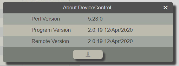

Device Control Update
For these templates, it will require the users to update their DeviceControl to the latest version. (2.0.19 12/Apr/2020)
Users can update their current DeviceControl installation and generally check for newer versions from inside their DeviceControl Interface.
Please click on ''?'' and then ''About Program'', and the software will check for the availability of updates.
When an update is available, users can update from inside DeviceControl, and then restart the software.
When the users will an older DeviceControl version will try to download a Template which requires a newer DeviceControl installation, then a notification window will appear.
