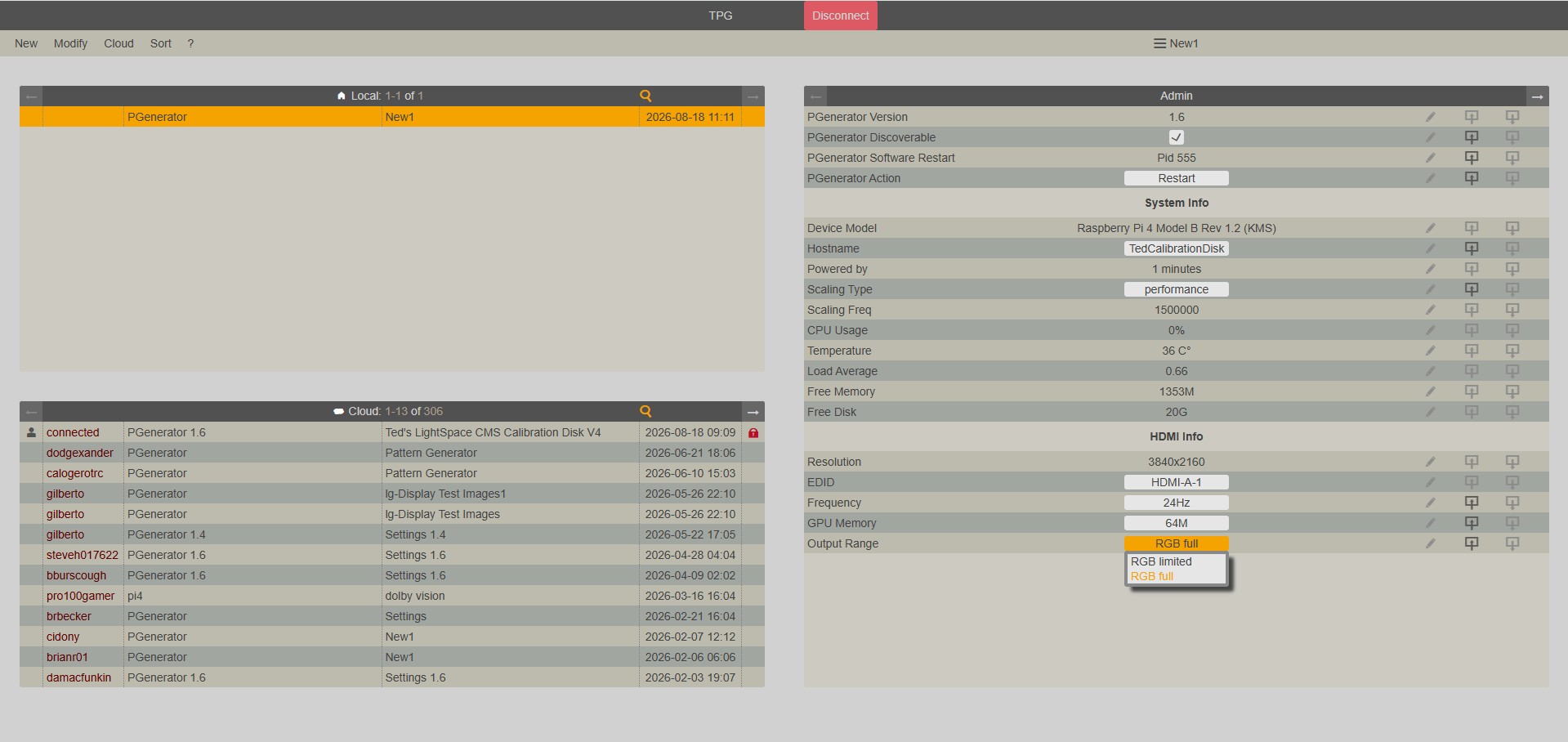

Already installed TPG 1.6 on my rpi, installed DisplayControl, ColourSpace ZRO detect it and i can send patches but...
How do I access 8/10-bit patchlists to perform the measurements shown here:
https://displaycalibrations.com/pgenerator_order.html
Also is there something to do in DisplayControl or I just can use ColourSpace to configure?

#13 | Posted: 18 Aug 2026 17:58
Problem solved. Thanks.
#14 | Posted: 19 Aug 2026 23:19
mga2009
Look into the email with Ted's PGenerator order, and you will see a customer download folder. Inside that folder, you will find the patchlists and DoVi guide.
From the Cloud, get only the two Templates from the user 'connected', Settings 1.6, and Ted's.
