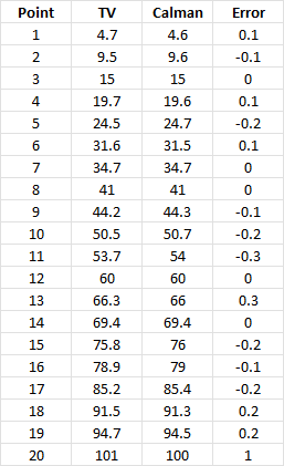

Even more unfortunately, calibration systems that rely on Autocal often have incorrect point mapping, such as Calman's implementation of Sony's 20-Point control, within which the control points are themselves not equally spaced.
Sony Calman Autocal Errors
Calman Sony Point Errors
The issue here is the Sony Control Points are defined in 10-bits, but Calman is only capable of working in 8-bit.
The only way around these issues is an extended guesstimation process, revisiting each adjustment point time and again, in an attempt to minimise the interactive nature of the misaligned points, but obviously any misalignment is inherently impossible to actually overcome with such an automated approach.
