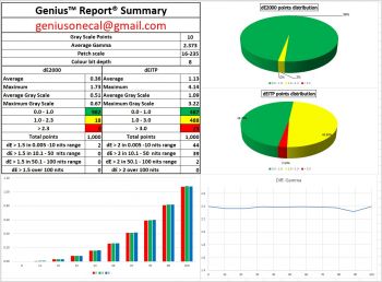

And from another user:
"I recently calibrated a 65 LG G1 and used the new Grey Primary & Secondary+ set which enables the new color engine.
The complete procedure only took 30 minutes including the 1.000p verification and the results are outstanding. When I find some time I will increase the verification points to see if a volumetric profile for OLED displays can skipped completely. First visual tests showed no difference compared to the 5k volumetric profile which need much more time. Another huge benefit is the much less stress for the panel because of the much shorter profile time compared to a volumetric profile.
The awesome sheet from @Anger.miki ; shows how good the new engine is working."
Customer Results
