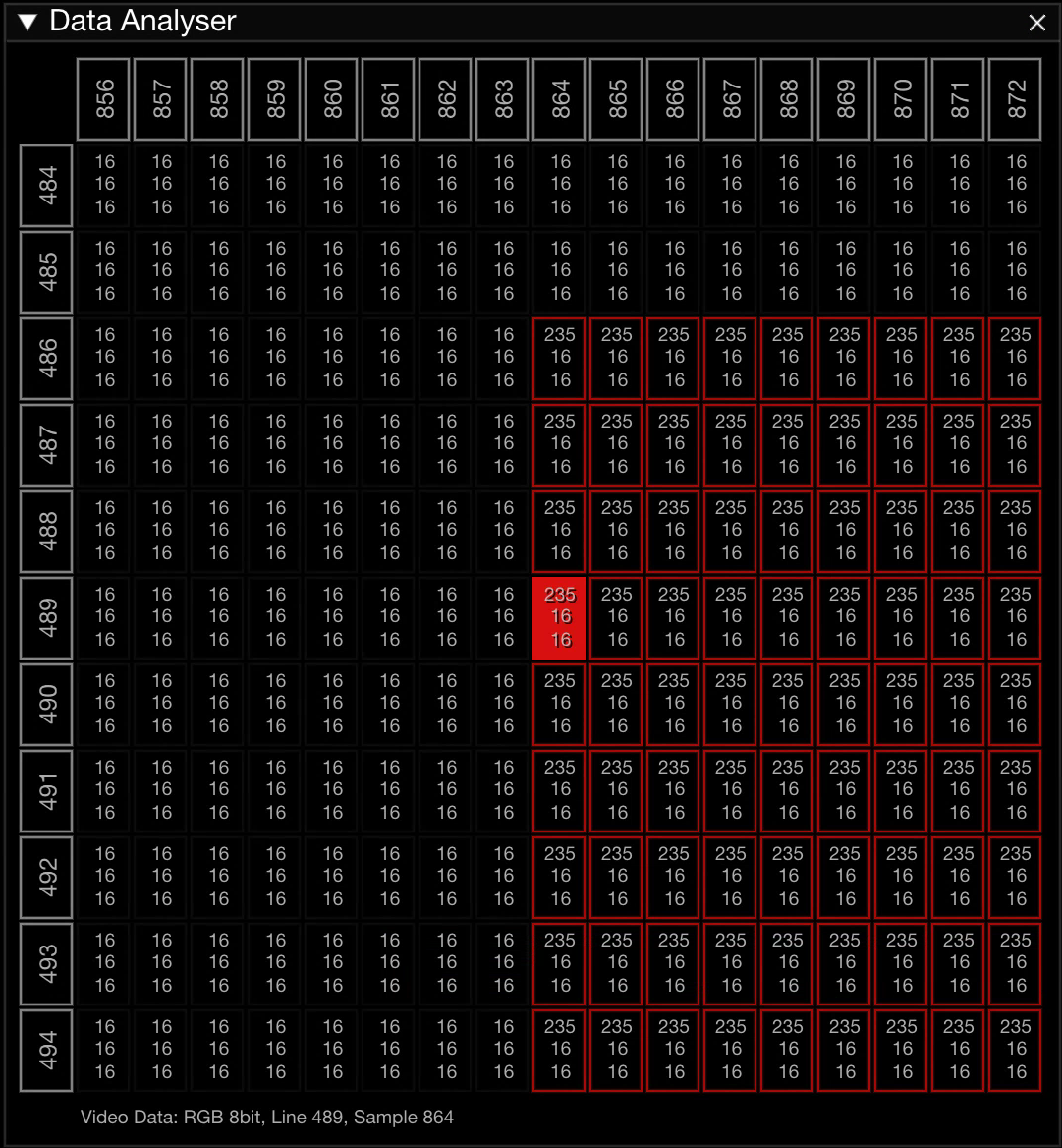

Below you can see an example of pixel analysis; it's the top left corner of the 100% Red patch with a video black background:
Pi4 Model B is bit-perfect with RGB-FULL setting @ Setting Template.

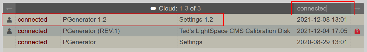

Users can refresh their DeviceControl Cloud (Cloud -> Cloud Refresh), write 'connected' at the Cloud search (magnifier icon), and drag-n-drop the 'PGenerator 1.2 - Settings 1.2 Template' from the Cloud to their Local:

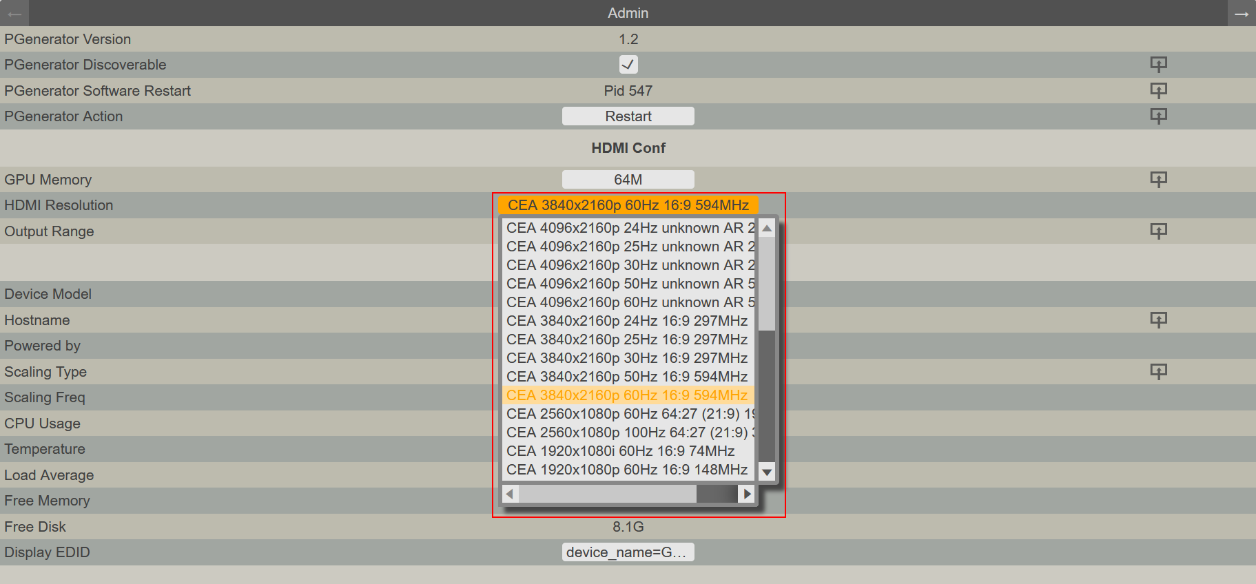

Settings Template 1.2 looks at the connected TV/Projector/Monitor EDID and lists the supported resolutions:
PGenerator will reboot after a resolution change, as always.

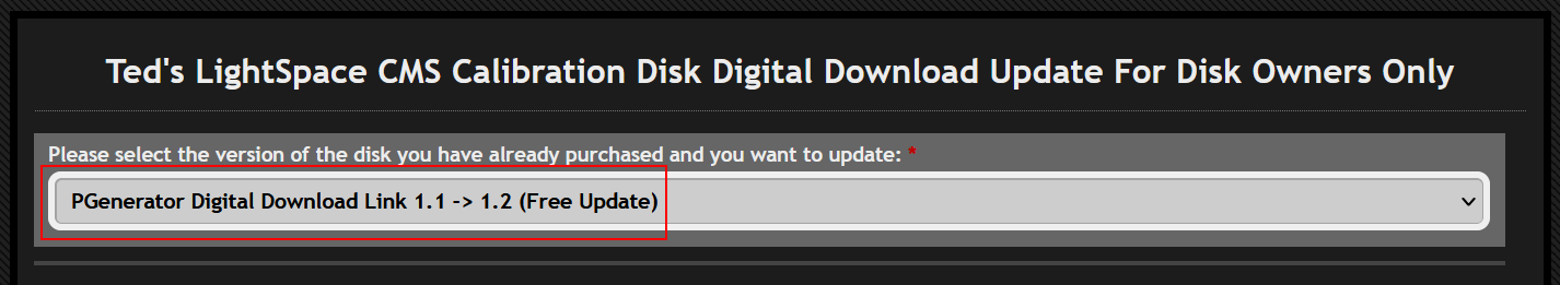

Download
PGenerator ISO 1.2 Download
For Ted's PGenerator ISO 1.2, please send a request using that form:
Ric is currently building Ted's ISO 1.2 for PGenerator; I will send the download link to the users later today or tomorrow after receiving and testing it.
