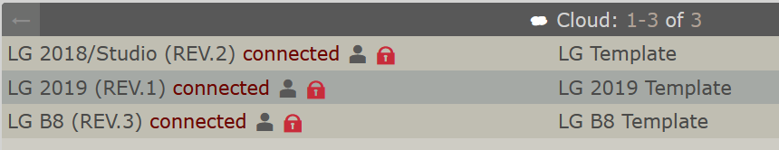

LG 2018/2019 Template for DeviceControl Interface is now available for Free to LightSpace users. Its ready a lot of time ago, and a lot of users currently using it.
A Piccy
The page where you submit to request access has not been updated to talk for LG 2019 release yet, but its planned to be updated when complete Guide for LG OLED Profiling for LightSpace will be released. (working on it)
The procedure is exact same as for LG 2018 Template.
Current DeviceControl Interface users, if they will refresh their Cloud, they will see the LG 2019 Template available, but see how to receive the update there: How to receive the latest LG Template Update for DeviceControl Interface.
