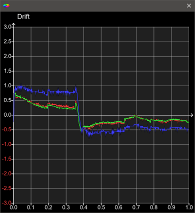

However, the pre-calibration shows there was a large jump in the display colour temp during profiling.
The 'Drift' option in LUT Generation should manage that, but such a jump is never good.
Drift
