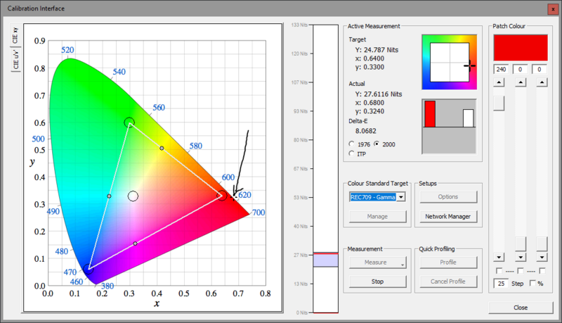

When I read red with my ID1 I get the following:
Red issue 1. The peculiarity of that red is that it is out of CIE. Its Z is negative.

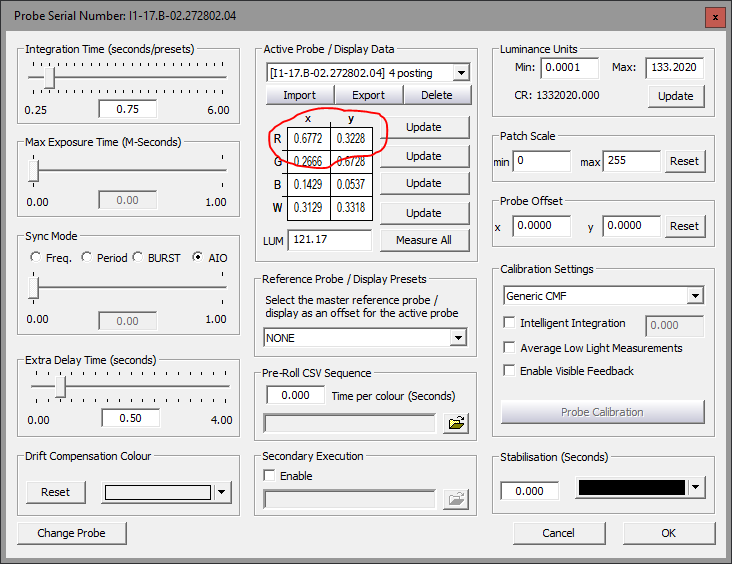

Anyhow, If I read all the colours for generating the profile I get something of different:
Red Issue 2

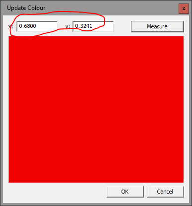

and its Z is 0, but if I click on measure the orginal value is taken:
Red issue 3

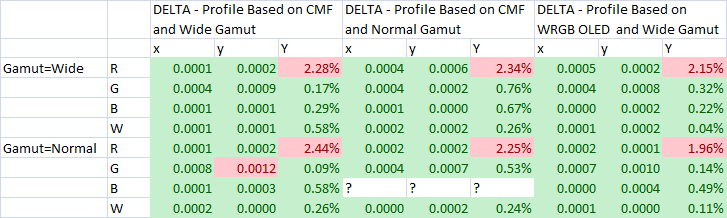

At this point I have tried to validate the the accuracy of the corrections I get: I have used generic CMF and wide and normal Gamut readings, and WRGB Oled and wide gamut readings. In one case not caring about negative Z. After profiling I have check WRGB with normal (rec709) and Wide gamut setting.
Here the outcome:
Red Issue
My conclusion: It looks that the algebra existing behind XYZ correction is not jeopardised by negative Z. Honestly I cannot tell if this is peculariar to my meter, but from now on, I will take a special care to red position when doing profiles based on wide gamut .
