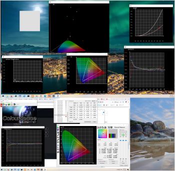

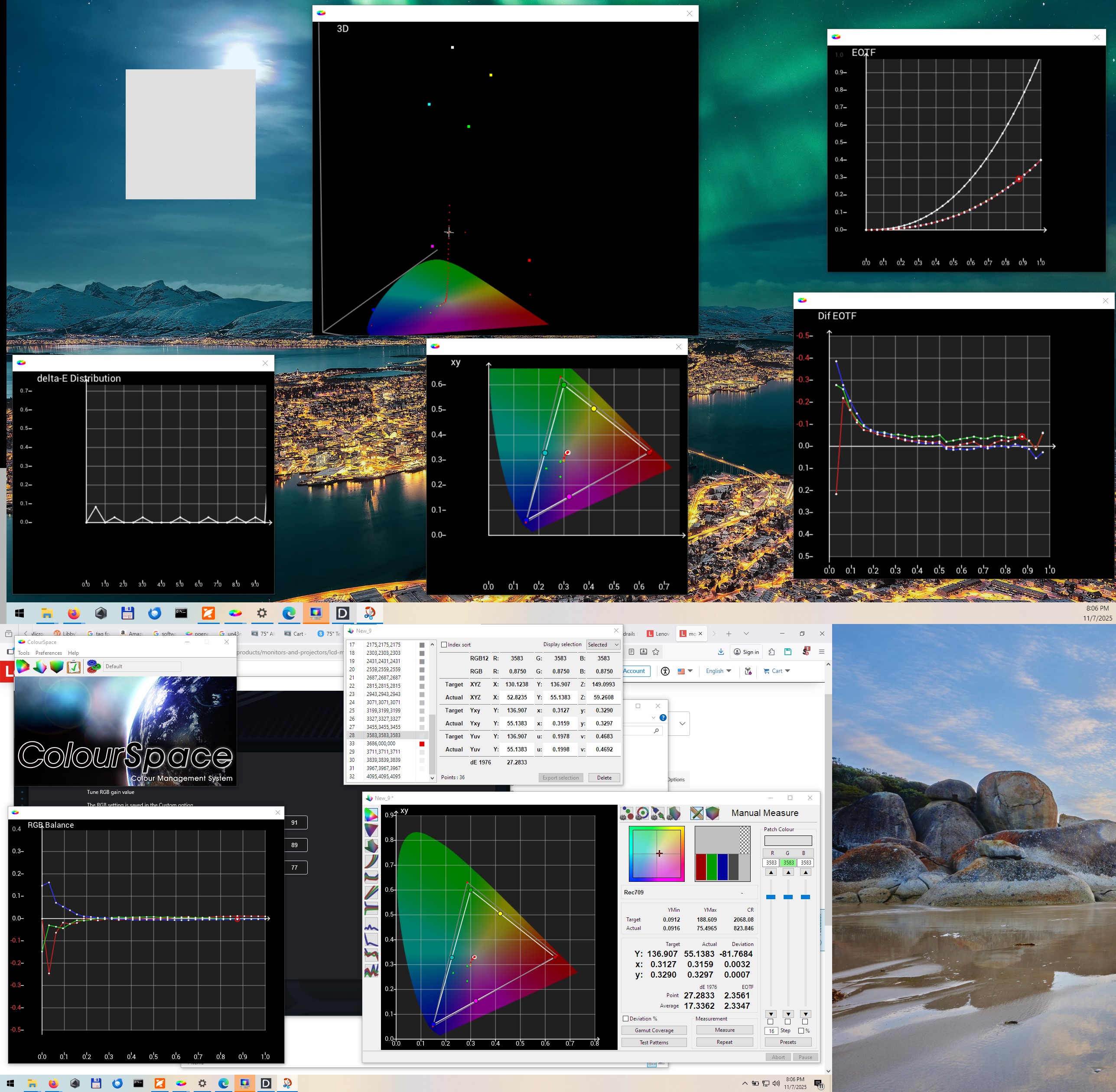

just wanted to share, newbie here. spent way too much time like we like to do but i'm pretty happy with the end results.
Lenovo P24q

You have no accuracy in either brightness or color coverage.
#3 | Posted: 8 Nov 2025 08:08
It looks lime your Target Luma is way higher than your actual measured Luma.
And you have not stated how you calibrated - LUT or manual adjustment.
If a LUT you may have a legal vs data range issue, based on the gamut result.
