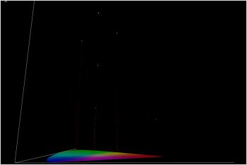

DeWayne - I thought I'd try top explain the issue in more detail.
Look at the attached screen grab.
This is the Cube 3D view of the profile.
The arrows show the 'step-change' issue.
To correct such a step-change the LUT would need to have points exactly either side of the step-change.
So that would mean having at least 73 points, and due the different step-change errors not being equally spaced, probably far more points.
This is actually separate to the likely need for the LUT to have Nyquist sampling, so means the LUT would probably need to be 3 or more times bigger.
Looking at this graph, the LUT would likely need to be 256^3 minimum.
Does that help?
