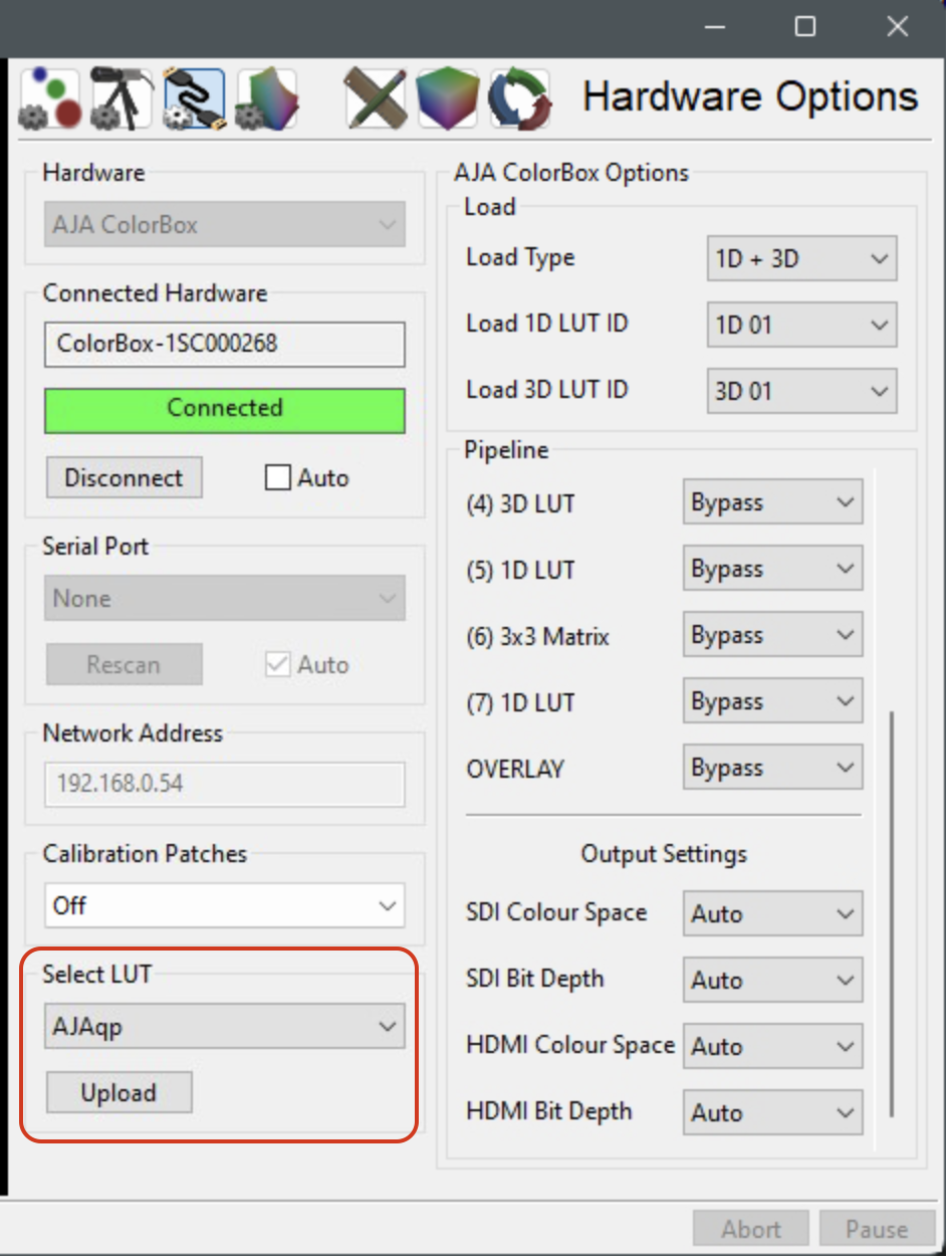

I don't have ColourSpace in front of me of me at the moment and won't be until Wednesday at earliest. However the setting that I'm trying to use is the only one in the dropdown menu I've highlighted in red in this screenshot .
Maybe the wording is a bit different from this screenshot as I believe the AJA integration guide, from which I've taken this, uses an older version of ColourSpace.
Anyway I believe it says Unity Bypass. I'll take a video of the issue next time I'm at the office.

The LUTs in that dropdown are 'Real' LUTs, unless you leave it at the Default which is 'Unity Bypass'.
And Unity Bypass doesn't upload a LUT - it resets the box's internal parameters.
