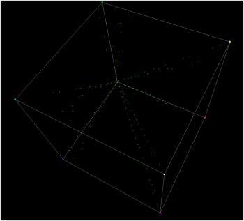

Problem 3. Volumetric graphs of Sub-Space characterisations appear to have wildly exaggerated errors.
You can see this trivially by running a Characterisation using Virtual Probe:
Target Gamut/EOTF: ST2084 Rec2020
Sub-Space: ST2084 Rec709
Patch Scale/Resolution: Legal 10 bit
Virtual Probe: OETF: ST2084 Primaries: REC2020
Characterisation: Grey, Primary & Secondary Ramp+
Resulting Volumetric graph:
As such, Sub-Space Volumetric graphs appear to be unusable.
