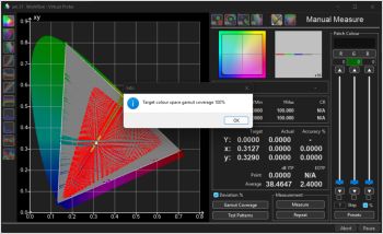

When computing the Gamut Coverage of a profile generated after a rec709 virtual probe to UHD rec 2020 a I have got the following:
Gamut coverage
That depends on the size of the chosen profile. Using a 3x3x3 profile I get a correct 54%. In the above case I have used a 21x21x21 profile (the max in built in).
I have attached it for replication. Anyhow already using a 4x4X4 profile I get 100%.

#2 | Posted: 3 Sep 2025 18:00
Seems you have found a bug with the virtual probe's perfect data sets.
Have you tested real profiles?
And yes, the value reported is 'Gamut' coverage.
Both the profile and the target colour space are normalised, as that is what gives the 'Gamut' coverage.
Author ebr9999
#3 | Posted: 4 Sep 2025 05:28
With real profile no issue.
If you move one of the points of the perfect profile, it works fine.
