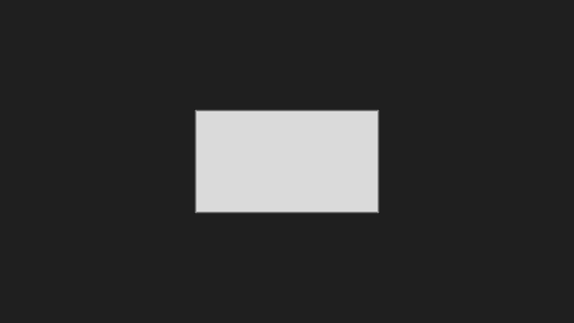

For example, setting Legal Scale within ColourSpace, because the display being profiled is being used within a Legal Video signal path, and also setting Legal within the TPG, can potentially cause double range compression - what is known as double-limiting - with ColourSpace sending Legal Scale triplet values (16-235 in 8-bit), and the TPG then re-compressing the input triplet values on output, causing the range to be compressed again to Legal Scale, resulting in a levels mismatch, with black being lifted to ~30, and white reduced to ~218, causing a reduction in contrast.
TPG Original Input
TPG Original Input
TPG Output Double-Limited
