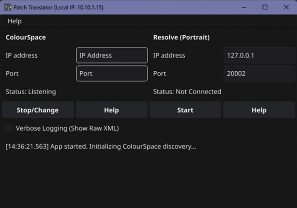

CS Patch Translator
As is stated on the Resolve User Guide, there are a couple of issues with Resolve's ColourSpace integration, which BMD have never fixed. One is that using Resolve as a TPG the bit depth is limited to 8-bit.
Weirdly, although Calman is limited to 8-bit accuracy as it has no native greater bit depth capability the Calman integration within Resolve can work at 10 bit.
CS Patch Translator takes advantage of this capability and enables ColourSpace to use the Portrait Displays/Calman options within resolve for true 10 bit TPG operation.
Something Calman is not capable of doing...

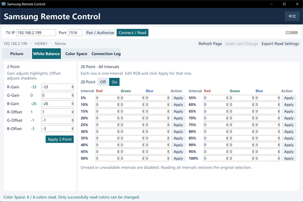

Samsung Remote
User LiYi has developed a Samsung Remote Control app, for manual adjustment of LG displays with ColourSpace, including ColourSpace ZRO.
The app can read and adjust Samsung TV picture settings directly over the local network, without opening the TV's picture menus.

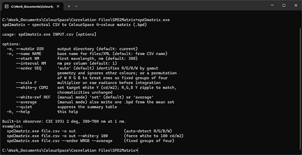

SPD2Matrix
Correlation Files to Matrix Converter
A major issue with the use of Correlation Files with Calibrite/Xrite i1D3 colourimeters is they do not take into account the probe-to-probe variations of individual i1D3 units, as defined on the i1D3 User Guide, and are also restricted for use just with i1D3 probes.
With ColourSpace's unique Probe Matching capabilities both restrictions can be overcome by converting any Correlation File into a ColourSpace Probe Match file, and this is what the Correlation Files to Matrix Converter (SPD2Matrix) app does.
SPD2Matrix can also be use to verify the suitability of any given Corr. File for use on you specific display.
